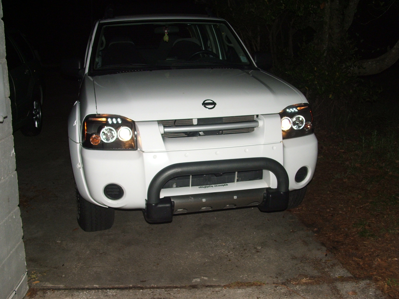

Hello everyone, i have a 2001 frontier Xe, just got those lights in the mail, small disappointment, HID's do NOT work with those lights, the beams pointed down wards at the ground, the take H1 bulbs so the h1 HID bulbs don't extend out far enough in the headlight enclosure to shoot the beam out correctly, as for the fitments, it fits pretty well but be careful when bolting them in, the plastic parts break easily, I have them installed but haven't gotten the led's and halos on a toggle switch yet, once i get those done i will post some pictures of the entire setup, i also have pictures of the headlights with the HID's but couldn't see crap. Had to drive home from a friends house 40 miles seeing nothing haha. Has high beam and low beams, low beams are the projectors and high are the lights next to to. OTher than that gives the truck and awesome new look, but i miss my HID's thinking about getting the PIAA Plasma Ultra Spark 8000k bulbs, 80 dollars but not totally sure if they work. Anyone know anything about those. well hope to get pix soon. later for now

here are some updated picks with lights working, only thing not working is the halo's and led's i will get around to getting those hooked up soon, just gotta run the wire inside the cab.. Enjoy. lemme know what u think. :-)

Just installed new halo projector lights wiring wasnt to bad, connected and pigtailed all the black wires then spliced them to the black wires from parking lights. connected then pigtailed white wire then spliced it to the green wire of parking lights what really F***** me up was one of the LEDs was grounding out on the housing it took me about 9 fuses to figure it out so if you get these lights check the LEDs in the halos to make sure they arent grounding out and dont order from vertex racing

Joined: Feb 25 2007
| Posted: Mar 25 2007 at 9:35pm | IP Logged
one more pic now I need to get fog and tail lights any suggestions
