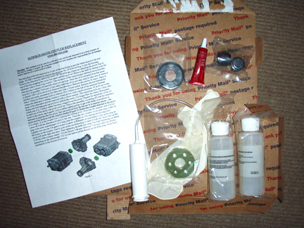

Got an answer for you BENT_TWIG85 on the Eaton M62 oil capacity!
Or in all honesty, a good boots-on-the-ground description and pic (not a direct tech manual quote) of the fluid volume of the replacement oil bottle.
=8oz=
More to the point, it's actually only the nose cone on the supercharger that's filled with specialized oil. And conveniently, once the old oil is siphoned out, the nose cone is simply refilled until the oil starts to dribble back out of the dime sized, Torx Plug filler whole in the front of the nose cone (just to the left of the pulley stem).
I just changed my nose cone's oil and coupler with one of the eBay kits that are so prominent now. (Just search eBay motors for Eaton M62 and you'll get the idea.) See the attached pics for example of the two bottles -one nearly refilled (not including the residue in the drain can and siphon syringe) with
old oil and the second bottle (supplied for presumably larger nose
cones) still full with fresh GM oil. This kit came with their own bottles filled with bulk purchased GM supercharger oil. But other kits just sell the actual individual 8oz GM bottles as well.
The second (before) pic of the kit includes rear roller bearings and nose cone seal -not included in the kit*. I purchased them in addition to the kit from this distributor for a complete supercharger rebuild. The third is of the Torx Drain/Filler Plug.
