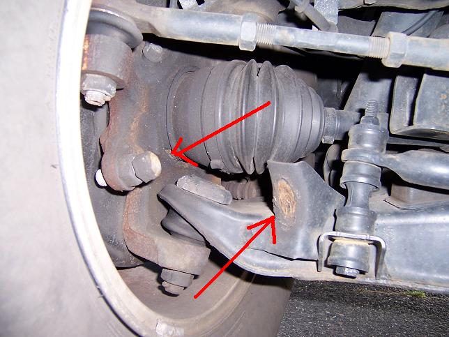

Bliving1978 Newbie
Joined: Dec 22 2006
| Posted: Feb 14 2007 at 10:16am | IP Logged
Benjamin5, What year is your truck? Take a close look at the sway bar connections to your lower control arms and see if there are any cracks there. It could be the bushings on those bolts trying to break through. These are the sounds mine made before these two brackets sheared off. By the time I found out what it was, my warranty was up. Others have said the bolts have broken and I think since then Nissan has put stronger bolts in their place but yet to have resolved the problem.
Since then I have taken out the bushing bolts because they kept clanging against all the other steering components when driving over dips. Although it stops the racket and increases articulation a bit, it also shimmys a little and I'm sure it will affect the wear of my tires.
see my photos for detail
see my photos for detail |
I'd better check my bushing bolts. Thanks for the picture.

Top pictures are of my 04 Frontier, I notice the noise mostly when I'm backing out of my driveway, I have the steering to the hilt and the end of my driveway into the street is a bit bumpy.
I'm going to lube this up with real heavy grease that we use on the forklifts here at my work and see what happens.
