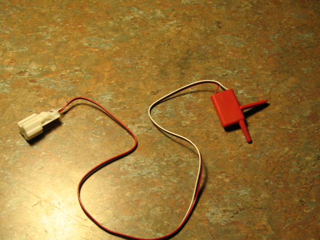

Hi Bcaughorn, as far as I can tell, following this thread for a while now, there is a two wire TCA and a three wire TCA. I was in contact with Chris Myers Nissan. They were out of stock at the moment of the two wire, it was $32 something but one thing lead to another and they checked what I needed for my '92 Sentra, and the TCA I need, runs $117. I have already bought a three wire for around $36, the two wire you got has the thermistor right? I have taken mine out and had it in my hand, so I know what it looks like. So is there a third type? Does anybody know what I end up with for $117? I can experiment for under $40, I don't feel so adventurous over the $100 mark. Any help would be great.

Hi bcaughhorn, Here is a pic of what I have been calling the three wire type.

yea thats the first one i bought. the 2 wire is different. its just a silver probe to push in

If you go to this link, about half way down the page is a picture of the TCA that I have.
http://www.nissanclub.com/forums/general-nissan-altima-discu ssion-1993-2001/271075-2001-altima-intermittent-ac-issue.htm l
I guess we are on the same page, and there are only two types. There is the $30 type, and the $117 type.

I forgot to ask, is the TCA in the picture, from the link, the one you got for $30 something?
