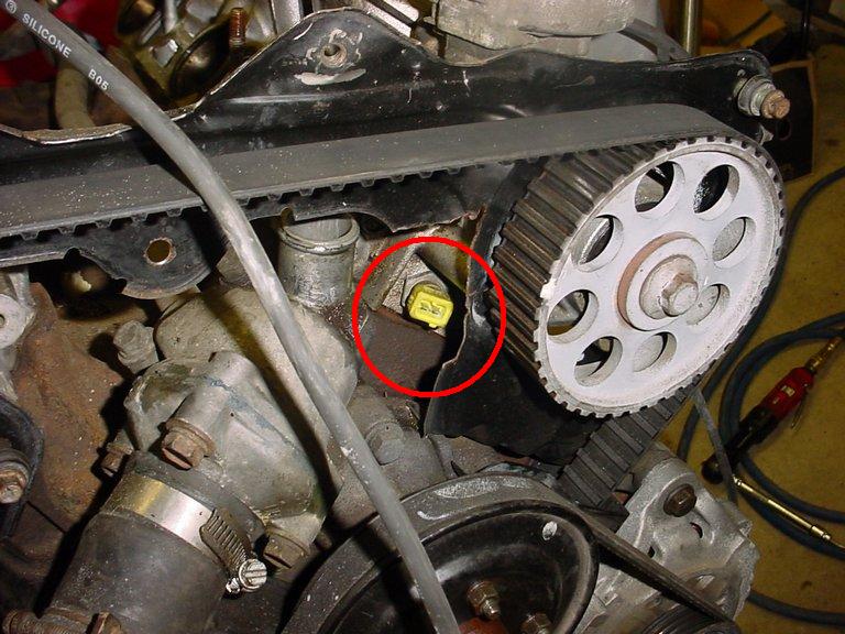

I'm starting to think that nothing goes in there.  I've been looking elsewhere on the net and I've only found a couple of entries relating to this hole.  In a different forum, someone asks what the sensor pictured in the hole is called, and someone responds that it's the cylinder head temperature sensor.  But most of the info I have found states that vg33e does not have that sensor, only the vg30.  Is it possible that it's an unusable relic of the vg's past??  My Frontier is 2001. Will someone verify this...looking behind the timing cover, under the distributor base.  Thanks. By the way, I believe the heads were simply cleaned up...the machine shop did not tell me that they were warped or cut.  Here's a pic of that sensor

wow, now it's coming back to me. the sensor pictured is the
 cyl. head temp. sensor on an 80's something Max. or Z car.
 Your's is located on the upper outlet housing.

         jgonz727 Newbie
  Joined: May 06 2012
           | Posted: May 08 2012 at 11:38pm | IP Logged
So, since it's not a sensor I need, should it have a plug??  Where would I get such a plug?
  Thanks guys.
  __________________ 2001 Frontier Crew Cab V6
  Joined: May 02 2005
           | Posted: May 09 2012 at 5:31pm | IP Logged
Use air into the hole and see if it connects to a coolant
 passage.  If it does you'll just need a brass plug.  If I
 could easily get to the heads for Max I could take a look,
 but they're buried right now.
  Joined: May 20 2008
           | Posted: May 11 2012 at 7:28pm | IP Logged
kcidmil, Really, it is 80's. I just looked @ a Genuine
 Nissan 88 Max repair manual and that hole is where the
 sensor goes, also on earlier years including the Z. 89 or
 90 they put the sensor in the upper outlet housing. I used
 to have to remove the sensor to clean the connections or
 replace it w/o removing the timing belt cover. (ah the good
 old days!!!)lol back at ya'.
         jgonz727 Newbie
  Joined: May 06 2012
           | Posted: Jul 11 2012 at 1:41am | IP Logged
Just to update you all...I found a plug for that hole.  I purchased it at Napa Auto Parts for about $3 and it does the job.  It took me a while, but I've put the engine back together and it's running like a champ again.
