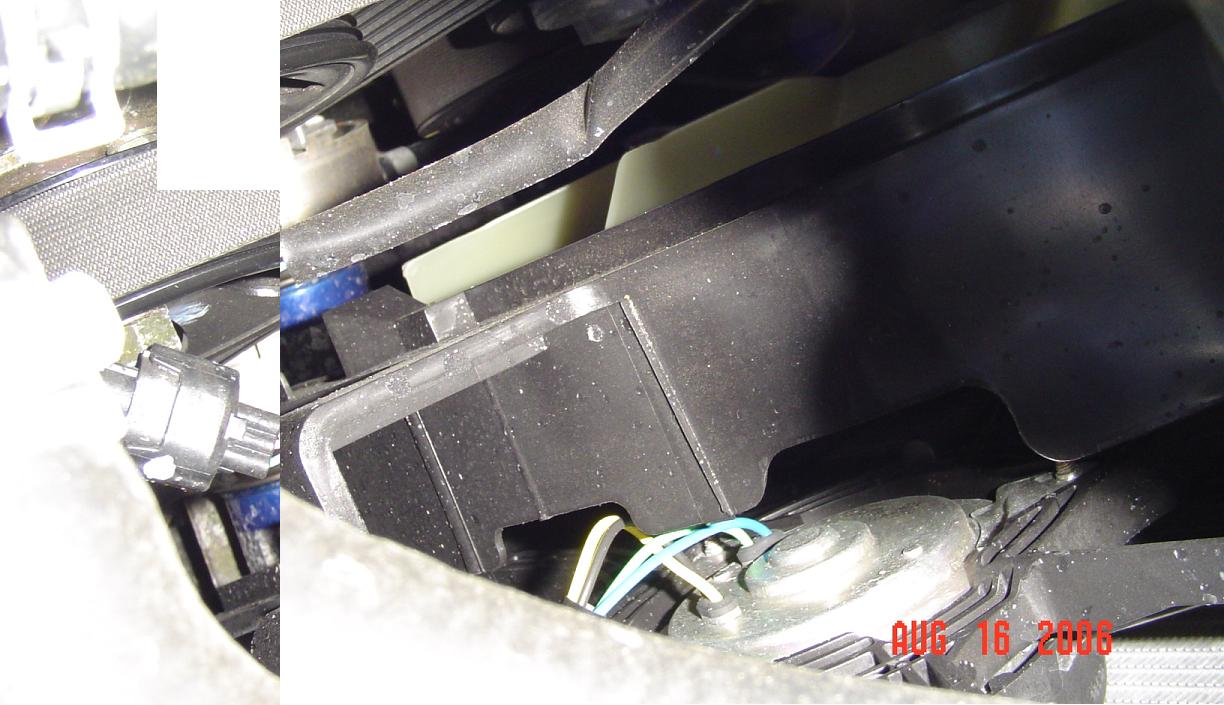

My 06 CC V6 has one electric fan on the radiator and an engine driven fan behind it. They overlap coverage slightly but the engine driven fan covers most of the radiator. It also sucks horsepower. Anyone converted totally to electric fans? top of this pic is the  engine driven fan (large white). Below that is the electric  motor driving the other  fan.

honestly, i dont think my engine driven fan has ever clutched in, even going up steep grades.  I hear the electric come on sometimes, but I have never heard/felt mine come on.  Im gonna leave it, but flexalite black magic would be a good bet to replace it with.

... The problem with replacing the stock fan system with an electric fan is it doesn't have the horse power available that the stock fan does. The electric fan depends not only on its electric motor but also POWER from the engine to run the alternator. When the alternator quits a vehicle can continue to drive a few miles on battery only. But adding the load of an electric fan will greatly shorten the range.
... There are pros and cons. I’ve seen electric fan motors that have burned out on the trail and the guy had a nice wait a couple of days for the special order replacement. A stock fan depends upon a belt so carry a spare belt. It is nice that a switch can be added to turn off the electric fans for deep water crossings.
... The stock fans suck because they really need the heat sensitive clutch in good working order to save power and fuel.
The flex fans are dangerous. The flexing of the fan work-hardens the area that is flexing. As the material hardens it becomes brittle and is subject to early failure. Many flex fan blades have broken and cut through the radiator core. I know a mechanic that was injured by a flex fan blade breaking while working under the hood of a car. I had a flex fan break off and ruined radiator core.
