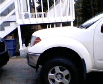

just got done took all day ,
r u guys ready here we go went to gregs shop and was going to get the standard lift kit but it was not high enough for me so we sat and talked and he made me a custom lift which included a spacer and half ,he took my stock a arms modyfied them buy cutting out the stock rubber ball joints and welded in a set of performance titan uniball joints that will out last the truck on top of that he installed the new ball joints on the underside of the a arm for more clearance which helped out the lift after that then he installed straps on both shock mounts
the lift came out awsome huge difference plenty high have to jump to get into the truck the ride is better than stock due to those performance uniball joints more info give greg a call (951)780-5331 at grp performance,
total lift in the front came to abou 4 and half inches but we forgot the number when we measured the truck stock so i will go check a stock 4x4 frontier and give you the right number
here r the pictures i will put more up later
