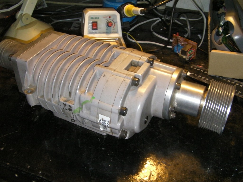

Anyways my dad is now running the D21 and ill be focussing my playtime to the D22 VG33 , planning a 2"bl and then theres still that M62 thats just gathering dust on my garage shelves
