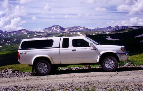

Added outward wheel offsets will increase componate wear. Nissan Hard Bodies and first generation Frontiers are noted for weak steering componates. They are Ok as is but with mods you may need to beef upthose parts also. I have BFG AT KO 31X10.50x15 tires. 5/8" T-bar lift and one inch block in the rear. My Frontier has many 'narly' miles on the rocks in the Colorado Rockies.
Note the extra clearance at the rear because of the lift and the removal of the bumper. I built a trailer hitch to protect the rear.
