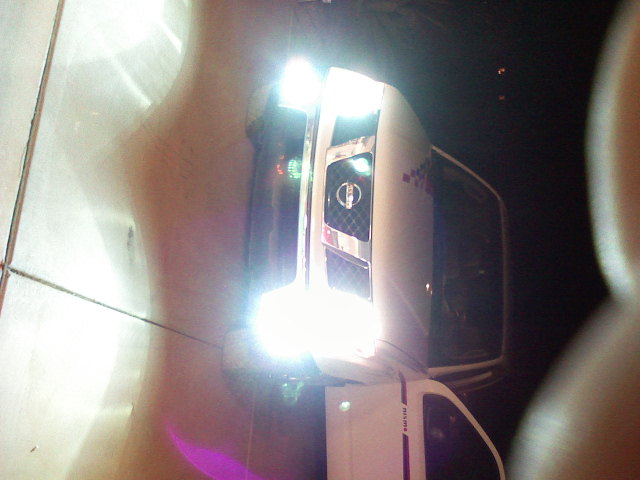

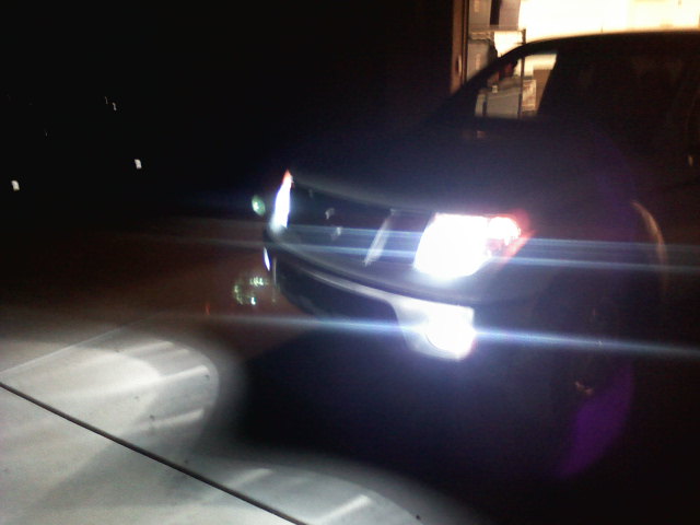

       | Has anyone tried the projector headlights off of ebay? I have a 07 and the stock headlights are not very bright and since my truck is in the shop getting some deer damage fixed i figured this would be a good time to upgrade them. If anyone has them let me know what you think about them. |  |  |    i wouldnt do the projector headlights i would get your self a hid light kit, thats what i did it works great. |

 |  2 things, 1st which kit did you get, those look great! there are kits for hi/low beam or just not... differance being like $300 between the two, 2nd, hotter or brigter bulbs will cause the headlight lense to fog or hase over time from over heating.  do your lenses get hot after long headlight use?   Nate

          I'm a truck driver (18 wheeler), and I do quite a bit of early morning driving. I'm gonna try and be as nice as I can here by saying that those headlights look way too bright. I don't mind folks modifying their lights a little bit, but some take it to the extreme, and in all reality, all it does is blind other motorist.

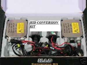

 |  I GOT THE LIGHTS FROM A GUY I KNOW,WHO HAS OPEND HIS OWN BUSINESS  THEY ARE TRUE HID'S NOT THE FAKE AFTERMARKET REPLACEMENT LIGHT BULBS LIKE YOU WOULD GET AT AUTOZONE  I GOT THEM FOR $150.00 A SET, AS YOU CAN SEE I HAVE THE  FOG LIGHTS ARE DONE ALSO, THESE BULBS USE LESS WATTAGE THAN YOUR STOCK OR AFTERMARKET HALOGEN BULBS, I HAVE BEEN RUNNING THESE LIGHTS FOR ABOUT 2 MONTHS NOW AND HAVENT HAD A PROBLEM WITH THE LENSES FOGGING UP.  BUT THEY ARE ONLY LOW BEAM BUT TO TELL YOU THE TRUTH I HAVENT NEEDED TO USE MY HIGHS AFTER I GOT THESE THE ONLY THING I WOULD DO IF YOU GET THEM IS ANGLE THEM DOWN A TAD SO THAT YOU DONT BLIND ON COMING DRIVERS, THEY COME I MULTIPLE COLORS,  ••ntbruncie; Welcome to the group!  The administrator of this forum has a rule about the use of Cap Locks. It does not bother me but I just want the administrator to know the mods are awake!...  ... lakota • No Cap Locks. Please do not post messages with the subject or post all in capital letters, or your message will be deleted. Words all in capitals are not only annoying but are read 50% slower than normal writing.

       | I'm a truck driver (18 wheeler), and I do quite a bit of early morning driving. I'm gonna try and be as nice as I can here by saying that those headlights look way too bright. I don't mind folks modifying their lights a little bit, but some take it to the extreme, and in all reality, all it does is blind other motorist. |  |  |  Gotta agree with you Smitty. Putting HIDs in place of the OEM halogens causes a lot of light scatter. The reflectors  are not made for such a bright light. This technology is 40 yrs old and was never designed for HIds. In my area folks are called ricers when they do that.   The only way to use HIDs are with projector headlight units. I've checked and have not found any projector units for my 06. I agree our OEM lights are pitifull and putting Piaa bulbs in didn't help much. Not sure if there is a good mod for this. Hugh

 |  Well; I may have to take back the part of no projectors suitable for the 05-07 Frontiers. I googled Frontier projectors and this is what I found. http://www.migicute.com/nissan1.html $300 for the projectors and plus a HID conversion kit MAY do the trick.  Projectors do focus the light down the road and don't reflect the light like OEM units. Not sure of the quality of these units. Aimed properly you shouldn't have folks flashing you.  Some HID conversions give you only low beam and no high beam not even a hologen one. I want to be able to have High and low beams. Lows Hid and Highs Halogen. There are also Bixenon kits. for hi/lo HID. Smitty,not sure if I agree with you on the staying home comment. Our headlights are crap. I drive an Audi with xenon HIDs. They are outstanding at lighting up the road. My high beams just fill in the blanks. I want to be able to come close to having the same quality of light from my truck without having to do extensive mods. The technology is there but not readily available. I'd like to see these projectors first hand before I pop for $300 plus a HID conversion Hugh
